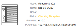

ReadyNAS 102 stuck at 'Checking file system' after USB Recovery
Hi guys, Been using a RN-102 for years now and I've been very happy with it and the support for it as well. Since last weekend I had my first major issue and that is that the unit started to do ...

Maybe connect the disks to a PC (either with SATA or a USB adapter/dock) and test them there?

Hi Stephen,
Thank you for the suggestion. I did that. I removed the disks from the NAS and connected them to my Windows laptop (with a USB to SATA dock).
From there I removed the partitions and re-formatted the disks.
After installing the disks back into the NAS, I entered the boot menu and started Factory Default again.
Guess what? All good now! The NAS is back online and good to go! Jeej!
Thanks so much! Very happy this worked :)
Problem solved!
