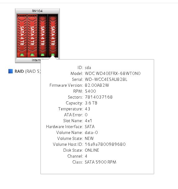

Everything seemed to work fine. Disk 2 resynced, and then immediately the logs show that "Volume: Volume data health changed from Degraded to  Dead",  disk 2 went online, and then there is a notification that disk in channel 4 has changed from online to failed, and the volume is finally changed to the volume data health from Dead to Inactive.

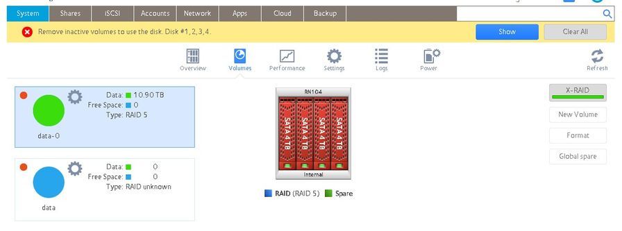

In Manage: Status Healthy. Data-0 0 free of 10.90 TB, and Data 0 free of 0. (i.e. there is another volume with no resources allocated to it.)
In the Admin page I get a Notification to remove inactive volumes to use the disk. disk #1,2,3,4.
There are TWO volumes, instead of ONE - as it used to be prior to the hot-swap.
All four disks are RED with green lights (i.e. all marked as spare).

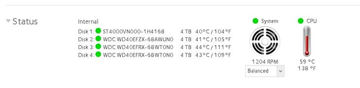

Performance tab claims all four disks are fine - all green.
And ALL disk have  a volume status of NEW.
All my data, shares, apps, etc are gone/not accessible.
It appears to me that the ReadyNAS, in its wisdom, after resync, somehow decided to mark my original volume as DEAD, then decided that disk 4 had failed (it hasn't, as it is currently listed as healthy in the Performance tab; also there had NEVER been any notification about any degradation or issues with disk 4), and then marked my original volume from DEAD to INACTIVE.
Basically, after the hot-swap, the nas went about to self-destruct as per above, and then created a new volume, so there are now two, both marked as full as all disks are marked as inactive.
    Regrettably, the ReadyNAS can misreport disk health - there are several cases I've seen where the NAS reports a failed disk as healthy.  Disks also can and do fail without warning, so the absence of prior notification is not definitive either.
    I recommend powering down the NAS and testing the disk in a Windows PC with WD's dashboard utility.  You can connect the disk to the PC using either SATA or a USB adapter/dock.   Probably makes sense to test disk 2 while you are at it.

    While it looks like it created a new volume, it didn't actually do that.  The problem is that it could not mount your existing volume due to the failures during resync.
    Analyzing and fixing this problem is complicated (and honestly, success is not certain).  The best option is to use paid Netgear support - likely you will need a data recovery contract.
    Another option is to connect all the disks to a Windows PC (likely using an enclosure of some kind), and then using RAID recovery software that supports BTRFS.  ReclaiMe is one package that other users have used with success.  This option would also require that you have additional storage to copy off your data.
    Also, keep the disk you removed.  It sounds like it hadn't completely failed, and you might need it as part of the recovery process.
