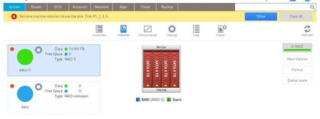

ReadyNAS 104 Firmware 6.10.7 - All four disks inactive following hot-swap of failed vol 2
I have four disks installed, 4 x 4TB. X-raid. One volume. For a while the system indicated that disk 2 was degraded ("Volume: Volume data is Degraded" and "Disk: Detected increasing ATA error count:...

Whiskeypod wrote:
Performance tab claims all four disks are fine - all green.
It appears to me that the ReadyNAS, in its wisdom, after resync, somehow decided to mark my original volume as DEAD, then decided that disk 4 had failed (it hasn't, as it is currently listed as healthy in the Performance tab; also there had NEVER been any notification about any degradation or issues with disk 4), and then marked my original volume from DEAD to INACTIVE.

Whiskeypod wrote:
Basically, after the hot-swap, the nas went about to self-destruct as per above, and then created a new volume, so there are now two, both marked as full as all disks are marked as inactive.
How do I fix this?
How do I get my data back?
While it looks like it created a new volume, it didn't actually do that. The problem is that it could not mount your existing volume due to the failures during resync.
