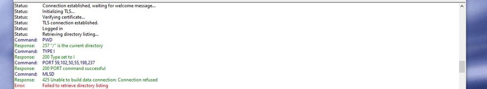

Hello,, Im Trying to get FTPS working, it works no issues with internal IP address but deom an external DNS it comes up with this error,
Port 21 is open, on my router and forwarded to the correct internal IP address
you can tell becasue TLS connection established and the user logged in,
FileZilla just failed to retrieve the directory listing,
this is also the case with software i want to use for remote connections,
any help would be great thankyou.

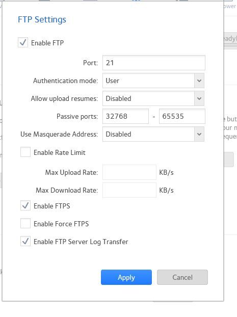

        You need to also forward the passive ports. It is not enough with just port 21.
        I suggest you limit the passive ports to a range equal to the amount of users you expect at a time. So if you expect 10 concurrent users/sessions maximum then set the port range to, for example, 60000 - 60010.
        These ports also need to be forwarded to the NAS, from your router.
        That is why it works with internal IP, but not external IP for you.
