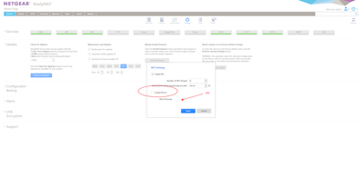

      I have enabled NFS at both the system and the share levels.
      Should I enable NFSv4?  What else do I need to enter?
        I wouldn't, unless you need a v4 feature.
        Probably nothing.  Though you might find you get better performance if you reduce the number of threads to 4.  The RN100 series doesn't have a lot of memory, and 4 threads would require fewer resources.
        Just something to keep in mind if the performance seems sluggish.
