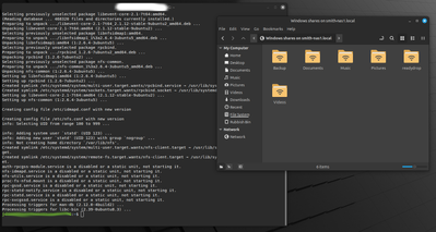

That seemed to run ok but as often happens, a thought pinged to me - "What would I see if I viewed my NAS within Files right now?" In fact, I see this:

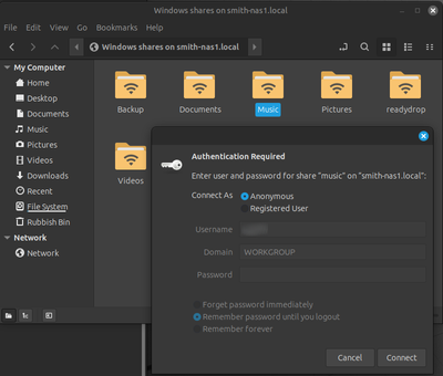

So next, I tried to click into the Music directory and was prompted for creds.
I wasn't expecting that as the tutorial I had been watching had stated that Linux wouldn't normally require user authentication on each share.

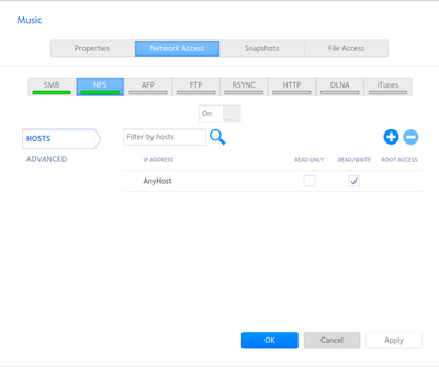

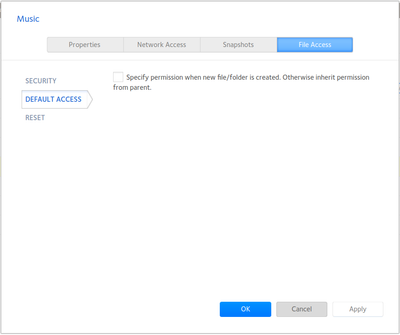

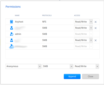

and
and
and
and
Does anyone have further wisdom for me in terms of getting this up and running?
Thanks.
