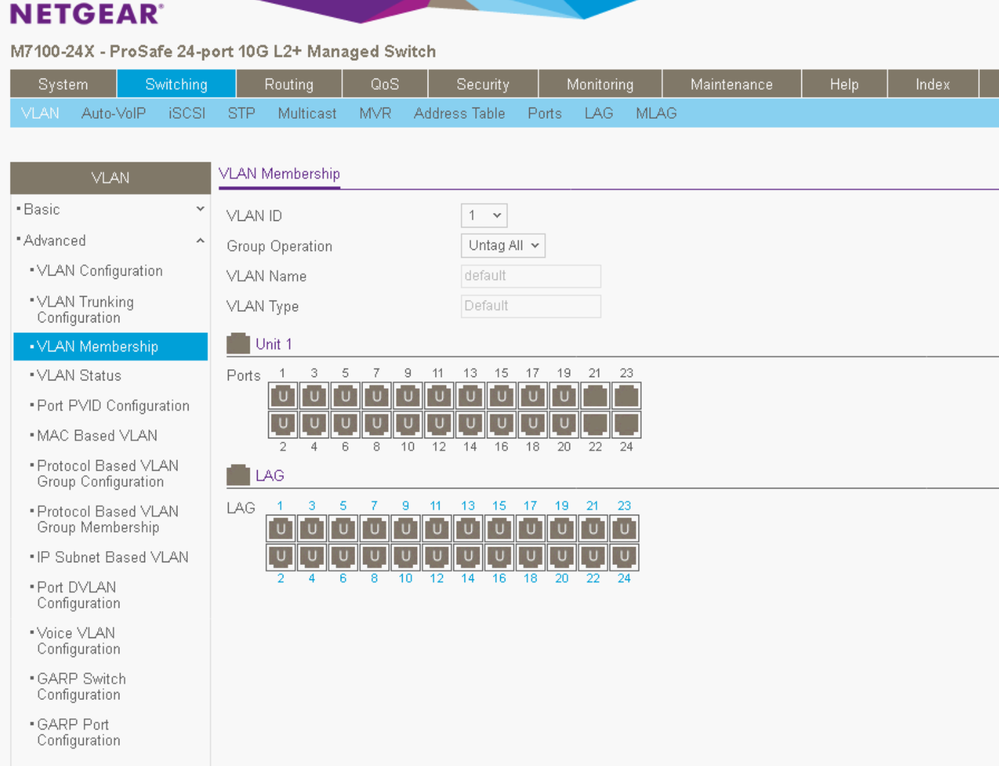

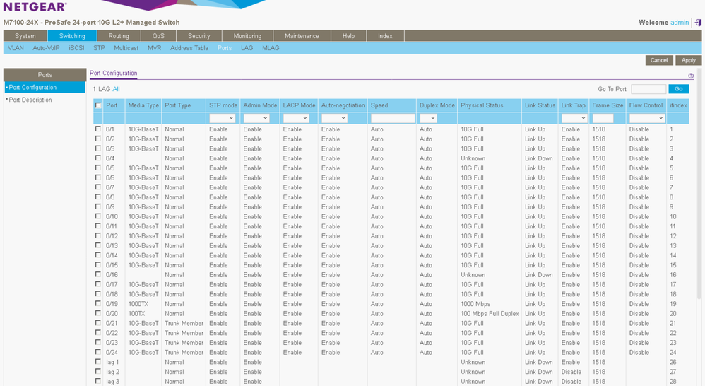

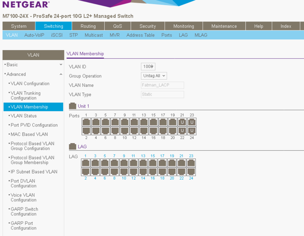

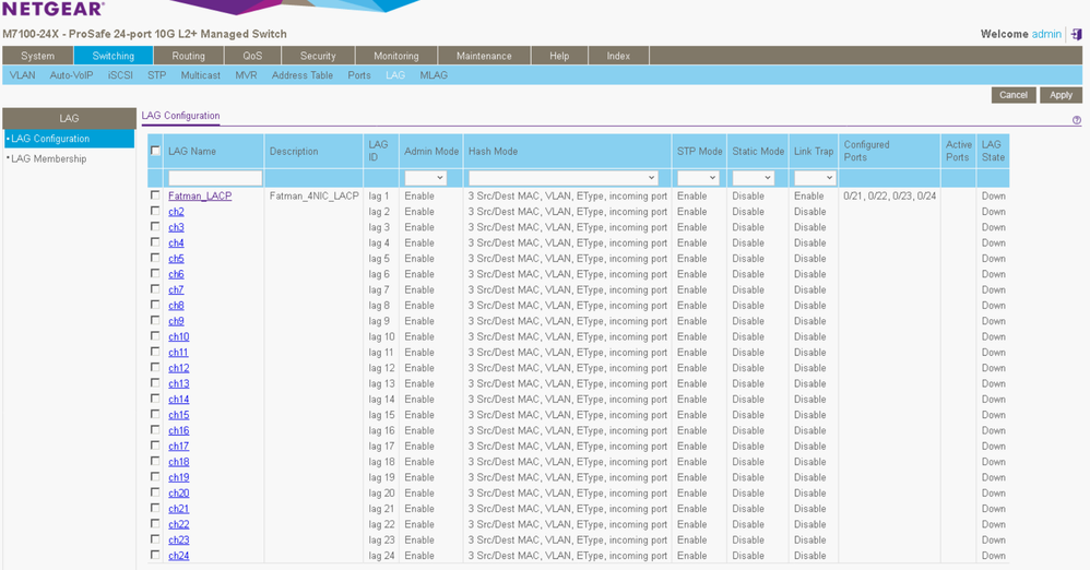

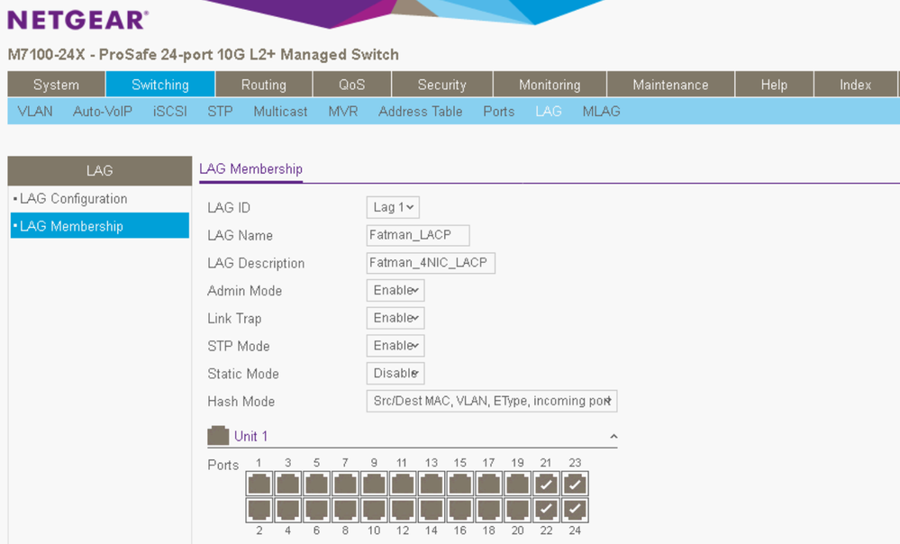

The switch shows the LAG state as down.
I've attached pictures of the Switch Config.
  • I rebooted the server and now MII Status show as UP.  So good news there.  Not used to having to reboot a linux server to fix something.

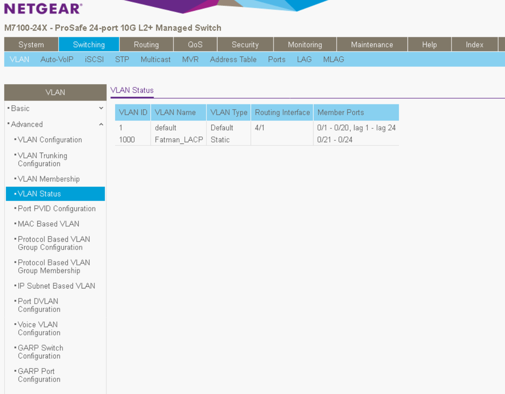

    I rebooted without a separate VLAN for the LAG ports.  The LAG and the LAG ports are in the same VLAN.  I can ping the server so I think it is working.  Do the LAG ports need to be in their own separate VLAN or should the ports and the LAG be in the same VLAN?

      It seemed that the rebooting the server helped applied the LAG settings configured.  About having the LAG ports (where the server is connected) be in the same or separate VLAN, it would be up for you to decided if whether you need the server be accessible by other users within the same VLAN or not.  If ever you need the server be within the same VLAN having limited access to a number of users, you will need to configure ACLs (Access Control Lists).  Let me share the article below as reference:

        Our end goal is to bond the 4 ports together for access for rest of the LAN.  I did not know if the four individual ports in the LAG need to be in their own VLAN-1000 and the LAG itself needs to be in the VLAN-1.  Right now the individual ports are in VLAN-1 along with the LAG and everything appears to be working properly.
