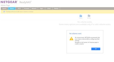

ReadyNAS 2100 does not detect any disks after firmware upgrade
Hey guys, I recently did a firmware upgrade on a ReadyNAS 2100v2 from 4.2 to 6.10.8. When I connect to the device through my browser it now tells me that it's not detecting any disks. T...

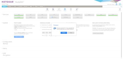

Try just installing it first, using System > Update > Install Firmware.
If you need USB recovery, then you can just use the normal 4.2.31.
- showtime3024Jul 05, 2023Aspirant
I think something crapped out during the OS upgrade. If I could get it back to 4.2 I would try the update again just to see if it would work the second time.
But as for System > Update > Install Firmware using the file you linked me... This popped up....
I clicked on reboot and after everything was finished I tried to login with the default password for OS 4 "netgear1" but it wouldn't work. Then when I tried OS 6 default "password" it logged me back in and nothing happened.... It's still on 6.10.8.
And it's still saying No disks or volumes found.
