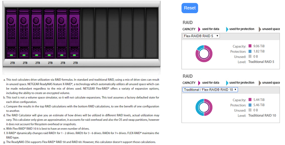

My ReadyNAS 316 was initially set up with 3 x 2Tb  drives. Subsequently, I added another 3 x 2Tb drives hoping to achieve a capacity of 9.06 Tb as estimated by the RAID calculator at https://rdconfigurator.netgear.com/raid/index.html as shown below.

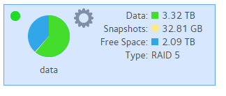

Although my configuration is shown as RAID-5 , it appears to have a capacity of RAID-10.  Why do I get this discrepancy?
Thanks
  • asaabey wrote:
     Expanding btrfs manually,  fixed the problem.
    Great.  I'm glad I was able to help. :smileyhappy:

    It wouldn't have switched to RAID-10.  I suspect that the NAS didn't add all three of the new drives to your array (even though the UI looks like it did).  One thing that happens sometimes is that the virtual disk created by the RAID array expands, but the NAS doesn't expand the file system to use that space.
    The recommended practice is to add one disk at a time (waiting for the resync and expansion to complete before you move on to the next).  Is that what you did?
    Can you download the log zip file, and post mdstat.log here?  It's best to put it in a "code" section ( </> icon).
    You might also try rebooting the NAS, and see if that triggers expansion.
