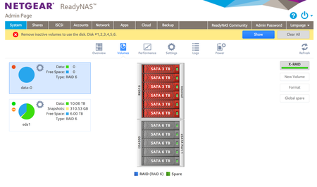

ReadyNAS 516 just upgraded to 6.7.1 and data volume has not loaded
Hi, I just installed 6.7.1 and on re-boot the primary data volume has not loaded - and suggests removing the inactive volume. I have two volumes, one of 6 drives in the RN516, this was a raid 6 vol...

/data-0/.timemachine was a subvolume, so a regular deletion didn't work. I removed the subvolume and directory, and now everything is mounted normally.
