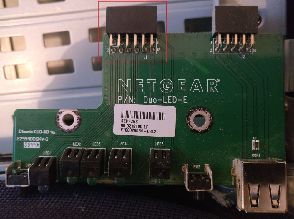

Basically, I am looking for information as to which pin does what on the connector from the board that power button mounted on it, connecting to the mainboard.
Would really appreciate help with this please. TIA

    Can you provide us an image/photo of the pins you need info so we can provide a specific answer?

        It is the pins on the board below that I am looking for, which I have highlighted in the red box
  • ok thanks.
    Is there any documentation that covers what each of the pins are used for, shown in the red box in the picture I posted.
    TIA

      Netgear has released no schematics or repair manuals for any NAS.  I don't have a Duo V1, but that appears to be a double-sided board that you could follow the traces on.  At the very worst, you could buzz them out.  From what I can see in the picture, the connector on the left is for the LEDs and buttons and the one on the right is the USB.  What is your end goal here?

        Basically, I have installed and setup an SBC within the ReadyNAS enclosure/case which is all fine.  Then what I wanted to do is connect the front power button and LEDs to the GPIO pins on the SBC. Which is why I wanted to know which pin relates to what.
        When I am home next I will try connecting to pins and will work it out, I was trying to plan ahead asking for documentation.
