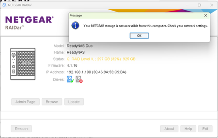

Readynas duo v2 cant access on windows 11
Hi I cant access my Ready Nas duo V2 from windows 11. I have Raidar 6.5.0 installed and can se the Server here but cant access the admin page nor the drive it self. I get the following messa...

I moved and got a new Router so before this was last time I was on the admin page.
I have SMB 1.0 enabled on the PC and when trying to access the IP it times out and can not reach it.
When I log into the Router I can not see the NAS on the list of connected devices but Raidar and detect the NAS

lundjacob wrote: I moved and got a new Router so before this was last time I was on the admin page.
Is your new router giving out 192.168.1.x addresses? If you assigned a static IP address to the Duo in your old home, it is possible that the Duo isn't configured properly. (That is fixable, but it woule be good to confirm that is the problem first).
- lundjacobMay 07, 2025Aspirant
The IP Range in diffined as 192.168.0.2-192.168.0.250. I tried to change the upper range to 192.168.1.250seems I cant
- StephenBMay 07, 2025Guru - Experienced User
lundjacob wrote: The IP Range in diffined as 192.168.0.2-192.168.0.250.
You can't change the upper value w/o also changing the subnet mask. But you can reset the range to 192.168.1.2-192.168.1.99, and then reconnect your devices to get IP addresses in the new range. (Addresses over 100 will still work, but will not be assigned by the router - eliminating the chance of two devices trying to use the same address)
Your other path is to do an OS reinstall from the Duo's boot menu. Instructions are on pages 15-16 here:
Be careful not to do a factory reset by mistake, as that will destroy your data.
The OS reinstall will
- reset the NAS admin password to netgear1
- reset the NAS IP address to use DHCP, so it will get an IP address from your router
It will not affect your data.
Once you have access, then look at your router web interface. Almost all routers have a way to reserve an IP address for the NAS. That is better than setting up a static IP address in the NAS web ui (as it avoids the problem you just ran into).
