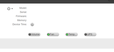

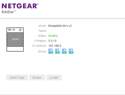

I assume this is because of bad sectors on other drive/s? The system is reporting healthy on RAIDar, but although I can see the shares, I can't drill down into them. The admin also won't show any system data, only the logs.
The logs are showing that "volume scan failed to run properly" and also that the "all the paths for the shares listed below could not be found", finished with "system is up"...
