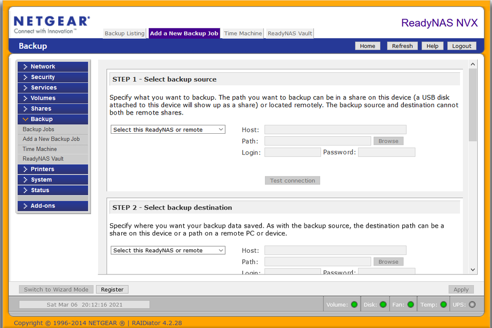

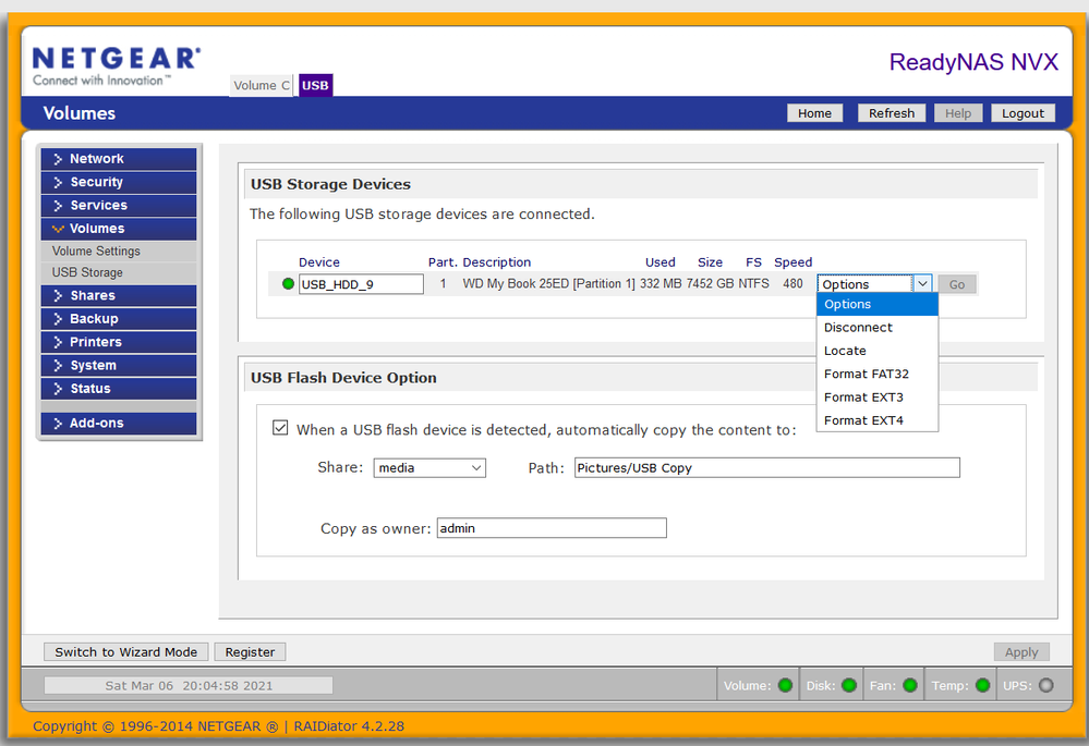

Replace #2 HDD but only after first connecting just-delivered 8TB WD USB HDD and perform complete Backup of all Shares.  USB HDD must be readable on my Windows machine.
PROBLEM:

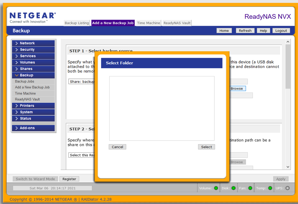

Shows that the USB HDD is in NTFS format but doesn't allow me to create a backup job.  When I try to select path to a folder on the selected share, it just hangs up (pls see photos) and won’t illuminate the “Test connection” button.

    ISvevo wrote:
    Replacement (Refurbed) same model Samsung HDD arriving in 2 days
    The size of the replacement needs to match, but the model doesn't need to match. Personally I would have purchased a new drive.
    ISvevo wrote:
    PROBLEM:
    Not sure what is going on.  But I do have a suggestion.  Your new USB drive is USB-3, but your old NAS only does USB-2.  Normally you'd get much faster speeds if you connect to the drive to a PC that is connected to your network using ethernet.  Even using WiFi might get you better speeds. Note that your failing (or failed) disk will slow down the backup speed.
    In any event, I suggest doing the backup over the network. Although with some pain you can use a NAS backup job, I suggest instead that you use a backup utility on the PC. FreeFileSync is a free one.  You could also just do drag-and-drop, but I'd suggest going with a more robust utility instead.
    It is possible that the failing drive is causing your problem.  If you are certain that it is the only failing drive in the system, you could also just pull it now and try again.  But I'd try shifting the backup to the PC first - at the very least that will give you more visibility into what's going on.

      @StephenB Thanks!  I left it alone long enough to have it finally show the share, but it still wouldn't allow me to get to test connection option, and now it shows that share as "Empty" which it isn't.
      I put that effort on hold and took your advice for direct connection to the laptop and ethernet to the LAN using FFS.  It took several attempts, but I think I’m close to having a backup to the USB drive of the key data.
