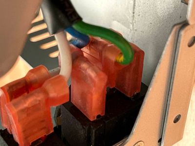

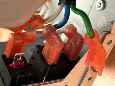

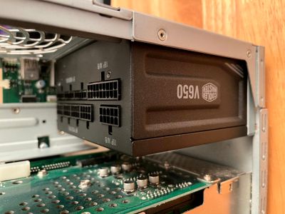

Just thought I would share with the community, I recently replaced the power supply in my ReadyNAS Pro Business Edition (RNDP6610) and located a drop in modular replacement that worked quite well.
I was able to use the:
Cooler Master V650 SFX Gold Full Modular, 650W, 80+ Gold Efficiency, ATX Bracket Included, Quiet FDB Fan, Semi-fanless Operation, SFX Form Factor, 10 Year Warranty (MPY-6501-SFHAGV-US)
https://smile.amazon.com/gp/product/B00FBBQERG/
Dimensions 3.94 x 4.92 x 2.5 inches
It's pretty much a drop in replacement with a 10 year waranty.

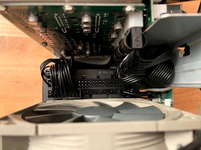

The only items of note I would mention:
- You'll likely need a extension for the 24 Pin ATX cable.
- You may need to adjust the rear fan a bit due to the modular ATX cable location connection point on the power supply.
Other than that - seems to be working great.  Hope that helps someone in need.
