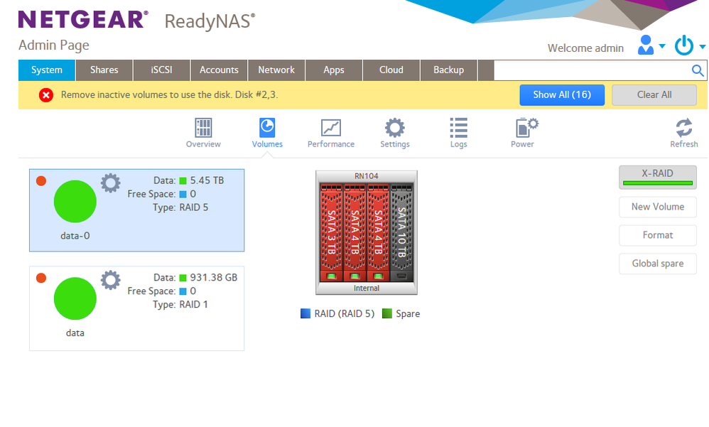

I need help as last night my nas rebooted and left me with the following, and bay 4 has only been added since to see if it would complete a sync.
No drives have reported failures and my volume was originally called Data with around 6TB used in X-raid it seemes to have moved everything to a new volume and left the free space in the old volume.

      I did boot up to read only but still could not see my data.

        One more thing that i can add is that the power supply is supose to produce 12v on 2 rails and i am thinking that 1 of those is for the HDD.
        On the night that it happened drive 2 and 3 dropped out and remounted several times, and the system shut down due to failure but when i noticed it and tried to restart it a message came up saying no drives found.
        Then shortly after the system had no power at all so i swapped the power supply and sure enough the old power supply had failed.
        since then i have tested the drives and noerrors at all so i am thinking that it is just in the boot sector and did not complete a resync..
