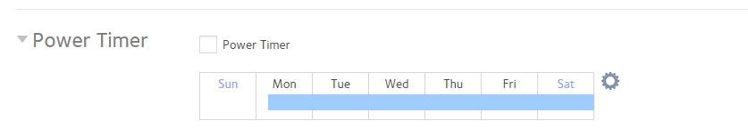

ReadyNAS Ultra 4 OS6.9.4 powering down
I recently upgraded my Ultra 4 to OS6 and everything appears to be working great. However, after I left home for Christmas my NAS went offline. When I got back from vacation last night, the NAS was...

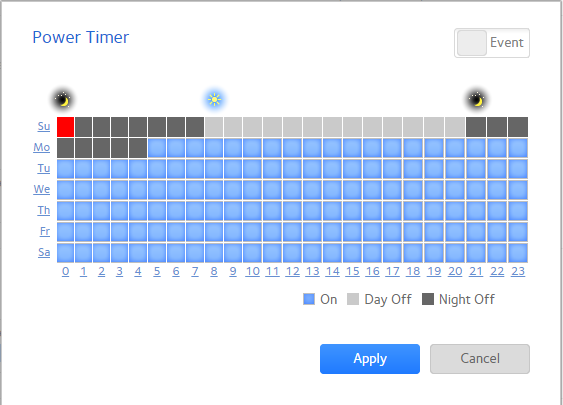

I suggest changing the schedule (lower screen shot) to always on, and see if that solves it.
If it does, then try enabling and then disabling the power schedule again (changing the schedule itself back to what you have now).

Looking at the logs both times its shutdown was at 5am, which seems too consistent to be a coincidence. But as far as I can tell, there's no scheduled shutdown enabled.
Dec 24, 2018 05:00:09 System: The system is shutting down. Dec 31, 2018 05:00:08 System: The system is shutting down. The power timer is unchecked.
Though there does appear to be some kind of power transition at 5am on Mondays. But if I read the graph correctly I'd expect it to turn on then, not off... And I'm not sure why it would take effect if the box isn't checked. Note I did not touch either of these settings, although before the upgrade in OS 4 there was reboot event set for Monday mornings. Perhaps this carried over poorly.
