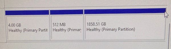

OK I pulled the drives out and checked them out one by one on a Win11 computer. All 4 drives spun up and each had 3 partitions...a 4 gb, a 512 mb, and a 1858.51 gb partition on each and it said each was healthy.
The Toshiba Utility did not detect any of the drives.
