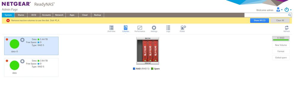

    • Sportradio's avatar
      Sportradio
      Hi,
      I have just turned the unit back on with all 4 original drives in place.
      This is what I see.
      • StephenB's avatar
        StephenB
        Sportradio wrote:
        I don't think XRAID was enabled. It was just RAID5
        XRAID was enabled (and still is).  The green stripe on the XRAID control tells us that.
        Sportradio wrote:
        This is what I see.
        Download the full log zip file from the logs page.
        If you can't interpret what it says, you can put it into cloud storage and send me a link via private message (PM).  Make sure the permissions are set so anyone with the link can download.  You send a PM using the envelope icon in the upper right of the forum page.
        Best not to post the link publically, as there is some privacy leakage when you do that.
      Sportradio
      I don't think XRAID was enabled. It was just RAID5.
      Your explination above was almost exactly what I did. Except I eventally removed drive 3 & 4 as well.
      Thanks for your help, I have been out of control busy, but I am running through your recommendations now. to see what will happen.
      I think the original drive 1 is now dead. but I will put it back in for the first test.
