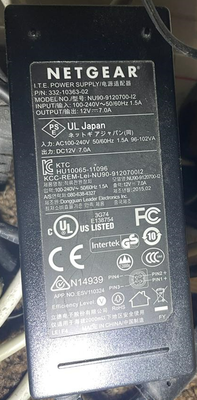

Hi,
My current power brick comes on for about 5-10 seconds then goes out - the light on the power brick is actually going out. Tried a new fuse and 3-pin cable completely with no difference.
I'm really struggling to find a NETGEAR original replacement!
Any suggestions?
Thanks
    I think you'll need to settle for a third-party power brick.
    • Sandshark's avatar
      Sandshark
      Sensei
      Look for a third-party one for a Synology DS410/411/412, which have the same pin-out and slightly higher input current requirement..  Plenty of options on Amazon in the $25US range.

        Thanks both.
        Sandshark I've just found another of your replies about this here: RN104 will not power up - NETGEAR Communities
        I'm interested in the "moving disks to another OS6 model" in case it turns out to not be the power brick. My current config. is 4x disks in RAID 10. Is there a special process or can I just buy another 4-bay ReadyNAS and literally move the disks as-is (assuming I need to move slot-for-slot)?
        Thanks again
