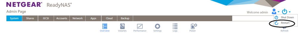

    Also does restarting the NAS from the admin web ui (NOT powering off) work?  Or not?

        Goldie1980 wrote:
        I tried the close down using the admin UI and then tried to start up from there too and the same result and it is very odd.
        Just to make sure we are both talking about the same thing...
        I am wondering if the restart control behaves the same way.  That doesn't turn off power, it just reboots the NAS.
