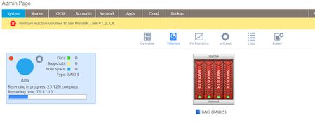

RN104 lock up and resync
System has 4 drives installed, two 6 and two 8 TB drives. I was deleating from windows two large back-up files (Acronis) to get more room. Part way through the process the NAS locked up. To powe...

- ecybertomMar 23, 2017Aspirant
I have not tried that. I was waiting for the resync to finish. Question, is their a problem with the 104 platform. I know it is the bottom of the line processor and memory wise. This is the second major problem I have had with this box. I also have a 214 that seems to ignore the same type of operation.
