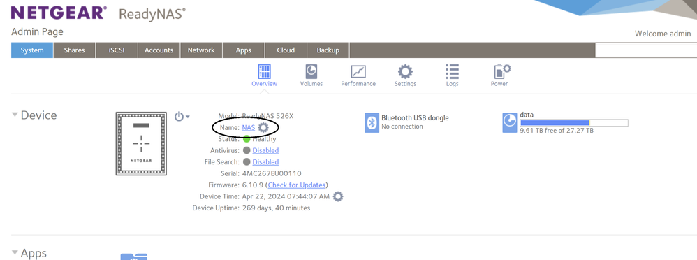

      • StephenB's avatar
        StephenB
        russellgray2024 wrote:
        When I received this message "
        The host name contains illegal characters. This may cause undefined behavior when using some network services. Please change the host name using only valid characters (A-Z, a-z, 0-9, -)."
        I assumed it was referring to my password as I couldn't find any "host name".
        Not your password.
        The hostname is the name of your NAS.  Click on the underlined link I circled and you'll find an option to change it.
        Note this particular ReadyNAS is just named "NAS".
        More than likely you have an underscore in the name, which is technically not allowed.  In any event, the only characters that are allowed in the name are the ones listed in the error message:
        • A to Z
        • a to z
        • 0 to 9
        No spaces, other punctuation, or accented characters.
