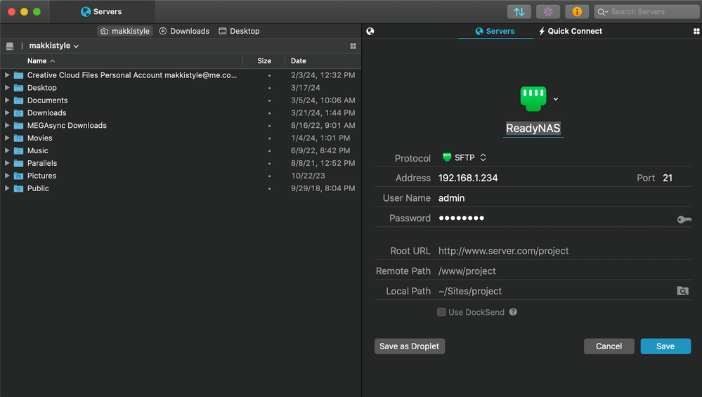

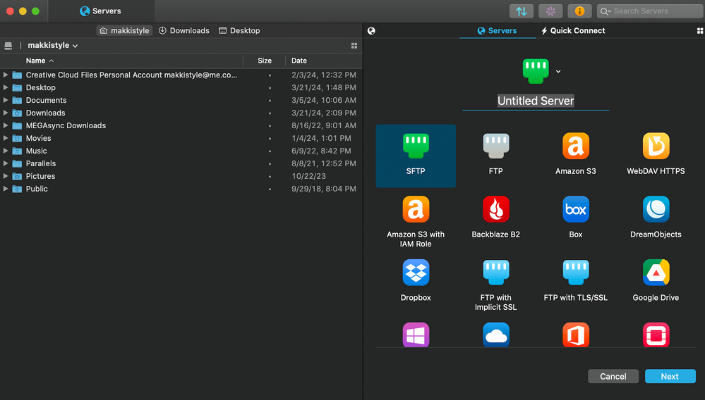

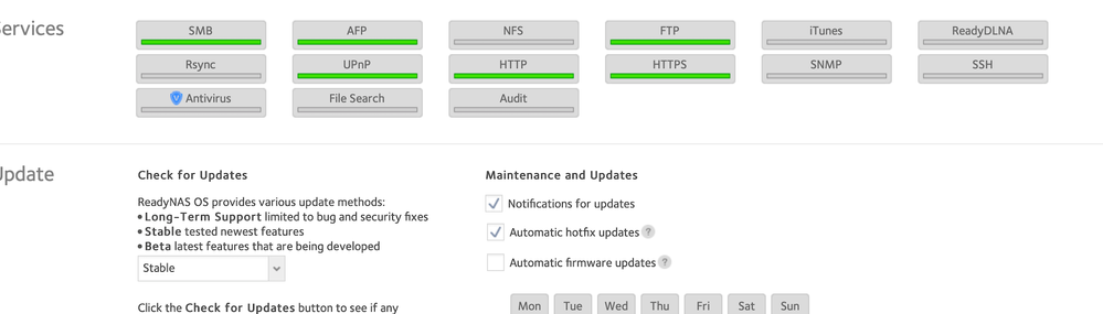

      Hi,
      Thanks for your quick reply .. I manage to downgrade the OS only
      the next step I was not able to connect to the server as SFTP
      and wasn't able to use admin control panel ..
      what the correct address to connect via SFTP app :
      I use Mac app :
      and in CP I activate the FTP but there was not option for SFTP:
      what do you mean by GUI ?
      • StephenB's avatar
        StephenB
        You need to enable ssh in the NAS in order to get sftp to work.  Make sure you enable password authentication when you do that.
        Also, log in as "root", not as "admin".  But still use the NAS admin password.
