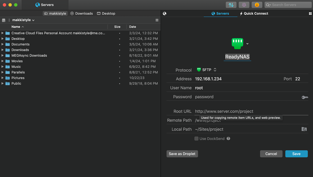

what the correct address to connect via SFTP app :
I use Mac app :
and in CP I activate the FTP but there was not option for SFTP:
what do you mean by GUI ?
- makkistyleMar 21, 2024Tutor
~Here are the connections options I have in the app :
- StephenBMar 21, 2024Guru - Experienced User
You need to enable ssh in the NAS in order to get sftp to work. Make sure you enable password authentication when you do that.
Also, log in as "root", not as "admin". But still use the NAS admin password.

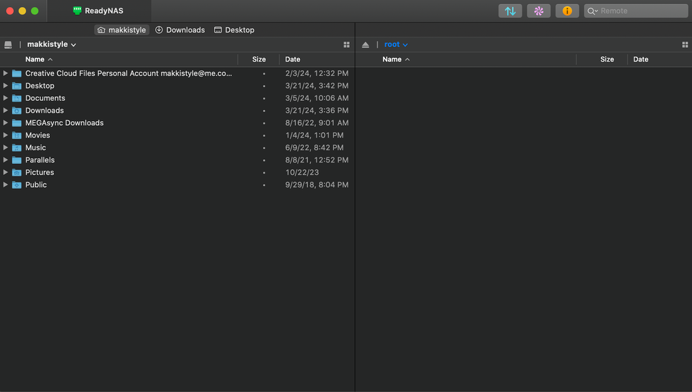

I loged in
but the root is empty
am i missing something ?
