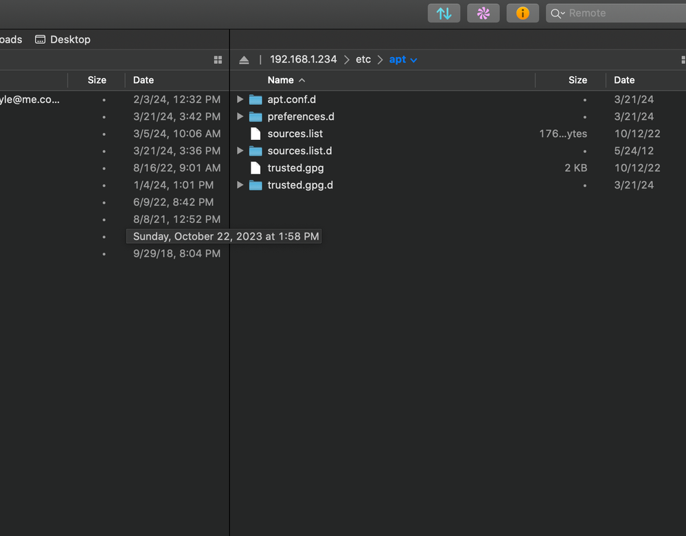

- makkistyleMar 21, 2024Tutor
I manage to access :
can you just guide me for last step
I just have to replace the file I downloaded ( sources.list ) over NAS version ?
what about the file ( apt.conf ) where it should go ?
