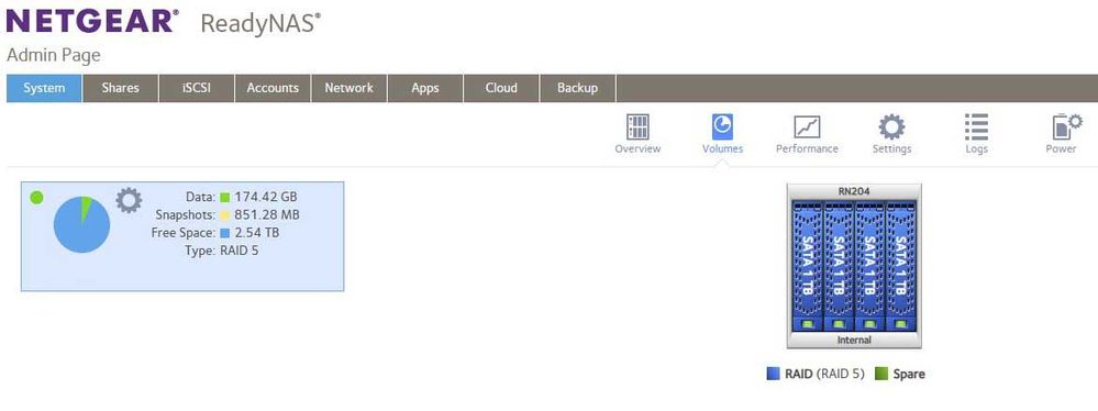

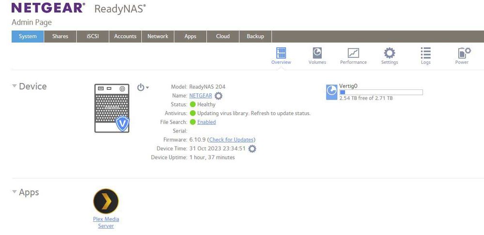

How much free space should this show using raid5 and 4 x 1tb drives. System shows healthy. See bottom three screen captures

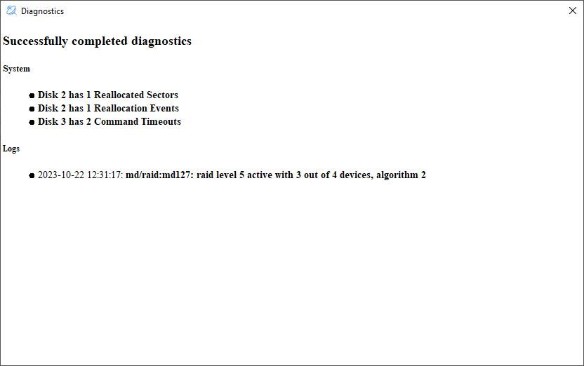

Raidar diagnostics reports this below. Does this report indicate only 3 of the 4 volumes are functional?
Successfully completed diagnostics
System
Disk 2 has 1 Reallocated Sectors
Disk 2 has 1 Reallocation Events
Disk 3 has 2 Command Timeouts
Logs
2023-10-22 12:31:17: md/raid:md127: raid level 5 active with 3 out of 4 devices, algorithm 2
    This question isn't related to disk health.
    4x1TB RAID5 yields a 3 TB volume.  However, the NAS reports total space in TiB (1024*1024*1024*1024 bytes), not TB (1000*1000*1000*1000).  3 TB is the same as 2.72 TB.  That is about what your volume shows - 2.54 TiB of free space, plus about another 0.18 TiB for the data + snapshots.
    ctxuk wrote:
    System
    Logs
    The fact that one disk is not in the array is particularly concerning.  The volume should be reported as degraded - is that currently the case? (it clearly wasn't when you took your screenshots).
    A single reallocated sector isn't a huge issue, and neither are 2 command timeouts.  Worth watching, to see if the numbers increase.
    If you don't have a backup of your files, you should put a backup plan in place.  RAID is not enough to keep data safe.
    Once the data is safe, I suggest running the disk test from the volume settings wheel.  There will be a log entry when it completes.  Then look at the stats again.

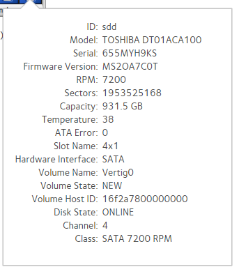

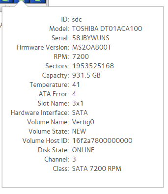

      The next day after having disc 4 drop out both days another identical disc was ordered. It then seemingly has behaved itself since then and is in disc 3 slot now (noticed it’s ATA errors so know which disc is which by that) Why later after online reading thought maybe a drive bay fault which is said to be common hence bay switch for the disc. The ATA errors have not increased and disc 3 put into slot 4 has still got zero errors for that, as too the other discs. [nb the disc which was ordered was put into my Qnap temporarily to get that setup after the lack of apps on here and the cumbersome uploads to it. RAIDar makes doing that so much quicker, glad managed to find that and install it on 31/10/23.

      Do not understand why all the volumes show the green block indicating that they are “Spare” and not just all blue blocks as per the “Raid” square.

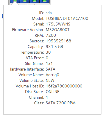

      Disc 1

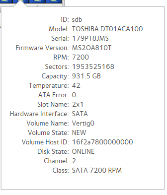

      Disc 2
      Disc 3
      This originally was disc 4 in the array when it arrived.
      The ATA error count has not increased at all.
      Disc 4
      This originally was disc 3 in the array when it arrived.

        ctxuk wrote:
        StephenB
        Do not understand why all the volumes show the green block indicating that they are “Spare” and not just all blue blocks as per the “Raid” square..
        The tiny little green square does mimick the power LED. A spare disk would be all green, not blue.
