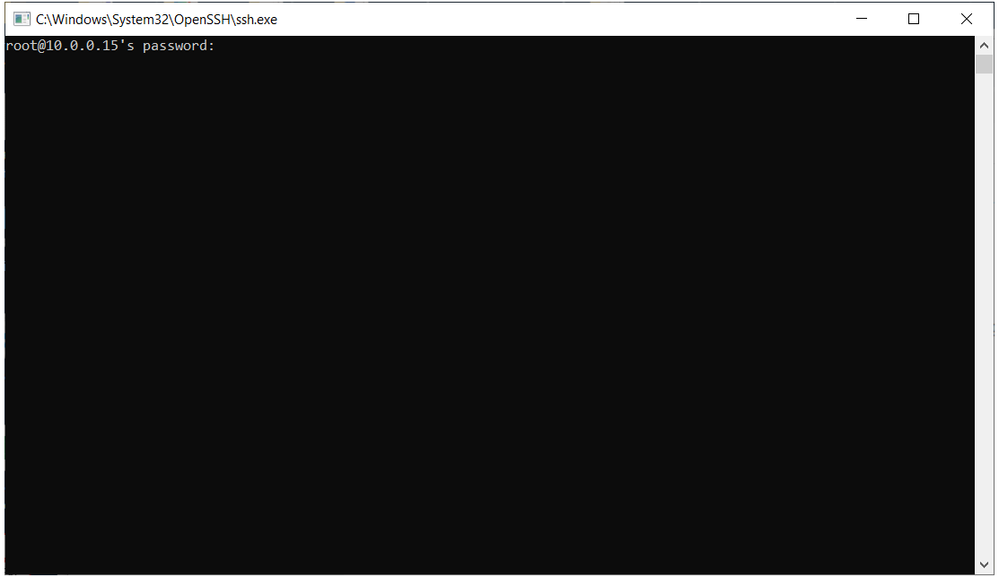

To log in with ssh, you enter ssh root@nas-ip-address or ssh root@nas-name into the windows search bar (using the real NAS ip address or name). That will bring up a black text box.
You will be asked to confirm the connection the first time (I forget the exact text, but it will talk about the fingerprint). After that you will see the password prompt as shown above. You enter the NAS admin password there. You should also log in as root btw.
