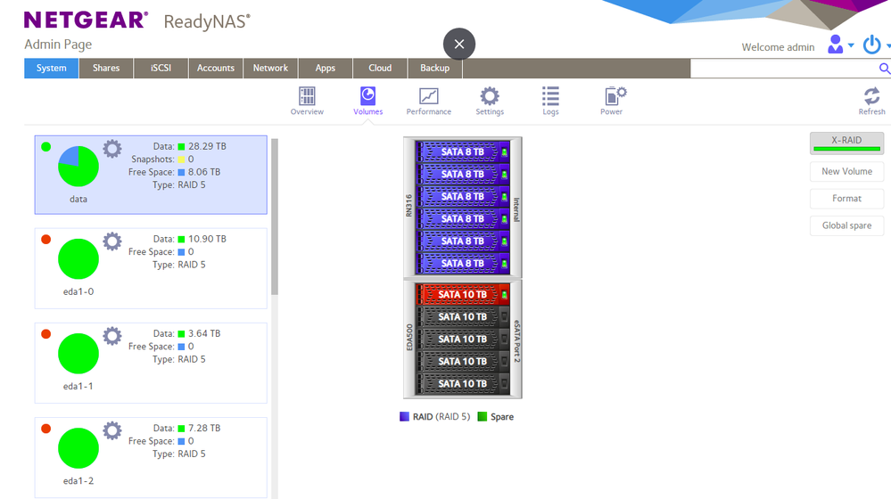

I just upgraded my firmware.  machine booted and then one of my EDA500s doesn't show up.  The other is also messed up.
Doesn't seem that netgear provides support anymore... I used to be able to buy a support contract but have no idea how to do that anymore.  Can anyone help me figure this out?
41 Replies
  • So if I disconnect the two EDA500s, my NAS boots up and all is well.
    If I turn one of the EDA500s on, it shows up as a mix of unusableness.
    If I boot up the NAS while the two EDA500s are powered on and connected, the NAS shows every drive as red.
    I am assuming there is something I can do to fix this.  Support tells me to post to the forums and won't tell me if you can purchase a support ticket like back in 2018.
    Anyone have any ideas?

      more info...
      Without the EDA500s on, I see my NAS showing up in the Volumes part with
      EDA1
      EDA2
      EDA3
      All with data/free at 0.
      I only ever had 2 EDA.
      So wondering if anyone can help tell me what to do to get these back.
      Does it matter which one?  Or does turning either one on cause this problem?
      • joe_schmo's avatar
        joe_schmo
        Tutor
        It's both.  Here's a screenshot with what happens when I boot the NAS by itself and then turn on one EDA.
