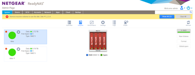

I tried placing the removed RN424 disks (4x4TB Barracuda's) back into my RN314, thinking they should just work. After all, these are the same 4 disks I swapped from the RN314 to the RN424, and that worked fine.
But this time, it didn't work. Getting the dreaded "Remove inactive volumes to use the Disk #1,2,3,4." Did some digging, found others who had this issue, none who reported ability to fix it without losing the data.
The data on these drives is fully backed up, so I'm not overly concerned. Plus, these drives are SMR and one disk showed 8 errors during the Disk Test, so I'll be ditching these drives eventually anyway. Still, would like to understand how this happened. One thing I did observe was that when I powered up the unit, the LCD reported the ReadyNAS OS is being upgraded. The OS on the RN314 was very close to the latest (in fact I thought it was on the latest, guess not). Maybe that created the issue, dunno. Weird thing is, I can access the RN314 just fine, including SSH'ing into it. It's just the volume on the drives - seems inaccessible.
- StephenBJan 05, 2024Guru - Experienced User
It depends on what happened - I have been able to help several folks remount the volume.
If you can get me the full log zip file, I can take a look. Send me a link via PM.
