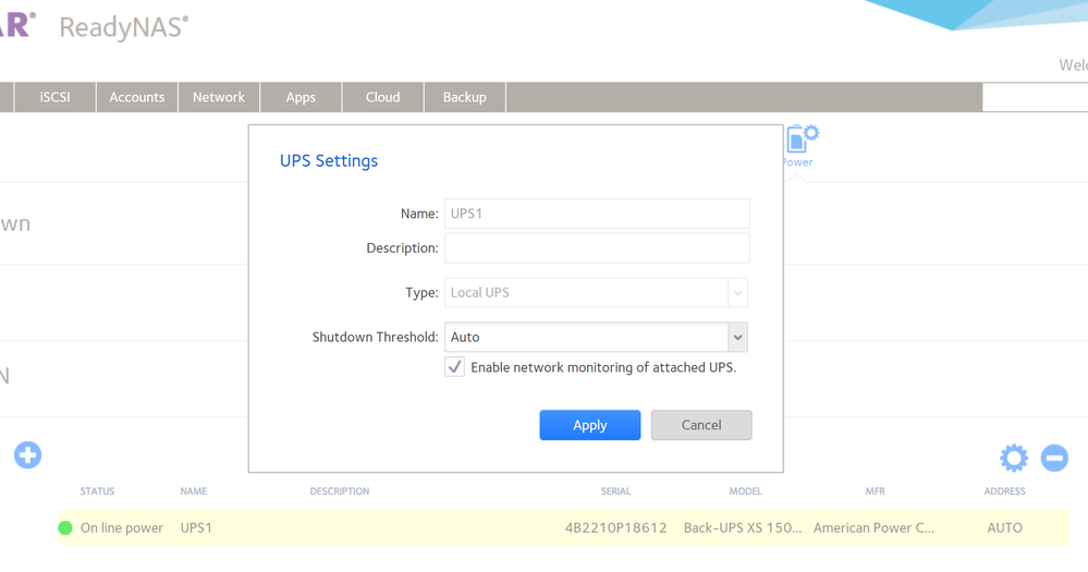

These settings are when I click the settings wheel for the UPS.
As I said above, this is only available on UPS connected locally via UPS (note the Type field above).
It sounds like your NAS isn't detecting the Eaton UPS for some reason. If that is the case, you might try a different USB port on the NAS.

As daft as it sounds, after swapping USB ports and test again with various manual entries and no success, I found USB-1 cable and swapped it for the current USB-2 variety that was in there previously, and the NAS added it automatically without me having to manually enter it, box-by-box. The only thing I had to do was check the box that preceded: ‘Enable network monitoring of attached UPS’, which never showed up before, irrespective of all the various options I selected.
I think it's more likely to be the cable that's somehow given up the ghost than the speed capability, with USB being backwards compatible.
What also helped was a snapshot from years ago that I took showing the UPS listed under the UPS section in the ReadyNAS GUI, with the word 'Auto' showing under the heading 'Address', and not an IP address I had to enter.
But really appreciate your help. I've been at this for so long.
