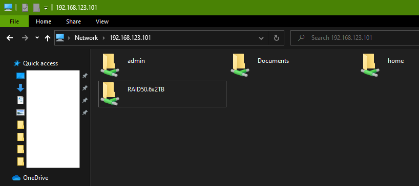

I access my ReadyNAS via SMB via \\192.168.123.101 in the address bar. From another Windows 10 device within my network, it should look like this:
admin is a default system folder
Documents is a share on the ReadyNAS that I've gone into and NOT hid (Settings > Network Access > Advanced > [unchecked] Hide this folder). I normally hide all shares. This is for troubleshooting this matter.
home is the default home folder
RAID50.6x2TB is the shared "root" volume. Documents is inside this folder for example.

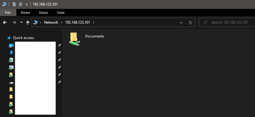

When I access my ReadyNAS as I normally would from another Windows 10 machine in my environment, I'm only able to see the Documents share because it's not hidden (expected) but where are the other shares from the previous screen shot?

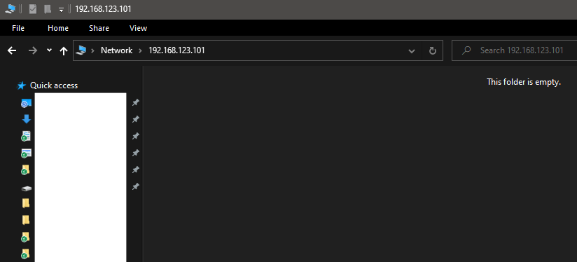

If I go in and hide the documents share nothing shows up at all now:

    The first machine is using the NAS admin credentials.  That allows it to see the private "admin" folder, but also gives access to the data volume and home.
    The second machine is not using the NAS admin credentials, so it doesn't see that stuff.  Likely it using anonymous access (since there is no private folder for a NAS account in the list).
    There is nothing wrong here as far as the shares you see.  If there is stuff in the root that you aren't able to reach from the second machine, then there is some work you should to to put that stuff into share(s).
    You can either make the first machine's access the same as the second, or you can make the second machine's access the same as fhe first.  If you have a habit a creating folders directly on the NAS data volume from windows, you would be better off making the first machine match the second.  That will prevent you from doing that.
    Either way, the trick is to use windows credential manager, and look at the username/password for the NAS credetntials.

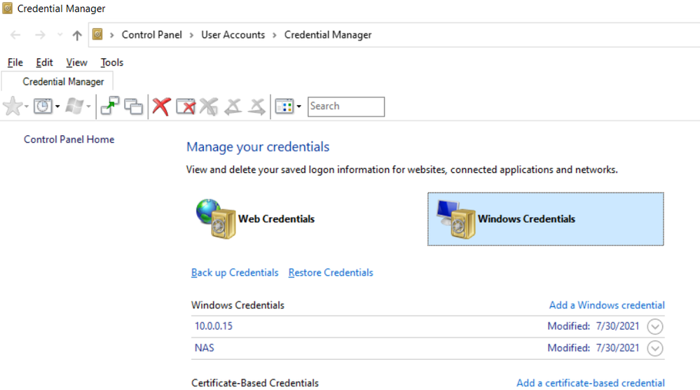

        But from your symptoms, I am thinking that you should double check the Credential Manager.  Make sure you are looking at Windows Credentials.   Here's one from one of my PCs - the only windows credentials stored are for the NAS (one using its name, the other using its IP address).
        It's worth double-checkidng the "Generic Credentials" section also, as there can be a set of credentials in there also.
