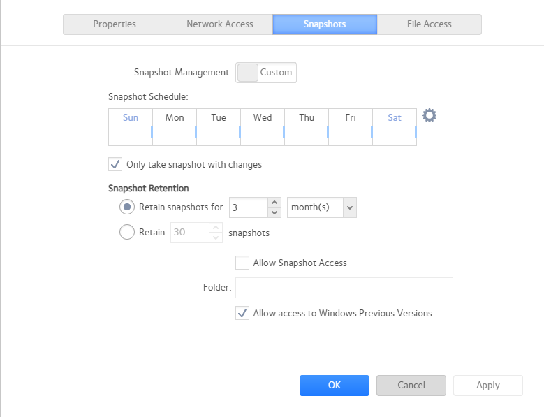

    What I do instead is set up my shares to use custom snapshots instead of "smart" snapshots.  My usual settings are shown:
    Using custom snapshots instead of the smart snapshots gives me explicit control over the amount of retention I want to have ("Smart" snapshots actually keep snapshots around forever - until that global threshold you are using kicks in).  As you can see, I just use daily snapshots - of course you can schedule them more frequently.
    Almost all my shares use the settings above.  But I have one where that holds encrypted PC backup images (it is the destination for my Acronis TrueImage backups), where the amount of space in the snapshot gets large very quickly.  So the retention is set lower there.  And I do have a couple of shares where snapshots are turned off (because the files are updated in place).
    Then I periodically take a look at the total space used by my snapshots.  If it rises higher than I want it to, then I just adjust the retention downwards (which can be done on a share by share basis).  But I haven't had to do that for a long time.  Even with 3 months retention, I am only using about 3% of file space for snapshots.  Of course the amount you will use will depend on how often you modify or delete files.
