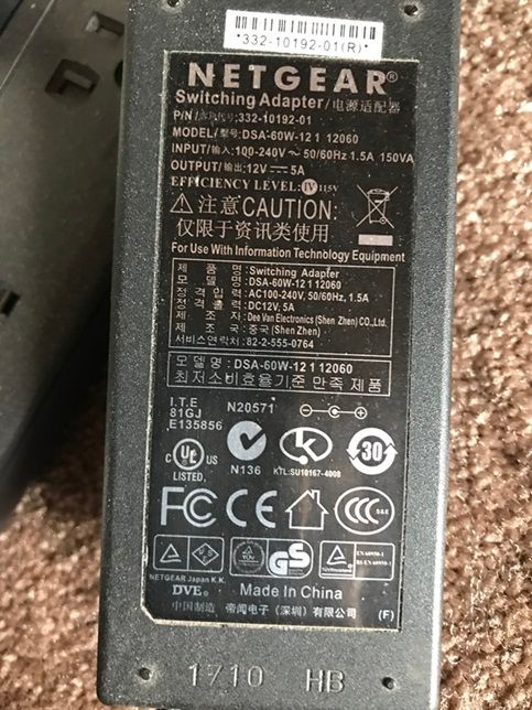

    • saudade's avatar
      saudade
      Apprentice
      Here's a pic of the PS from my Duo V1.
      Center is +.  PS is 60W.
      • michaelkenward's avatar
        michaelkenward
        That's a good start. I'd start with the suggestion from StephenB that you search for something that claims compatibility with your Netgear device. If you can't find an exact match, anything that says it supports the whole range should work.
        Netgear occasionally comes up with something odd, but mostly it sticks to transformers that cover a raft of devices.
