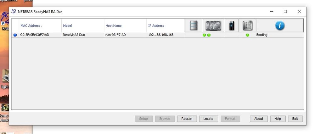

I don't know if this is going to help determine what is wrong, but It seems like the raidar is able to find the nas for about one minute while it is booting up, but after about a minute or less, it does not find it and shows a help screen.
I took a couple of screen captures so you can see what I see.
I have only been able to accomplish this after doing an os reinstall with the laptop connected directly to the nas ethernet as you suggested.
I have not been able to find it through the browser.

No blinking led's.
It shows the two disc led's solid
