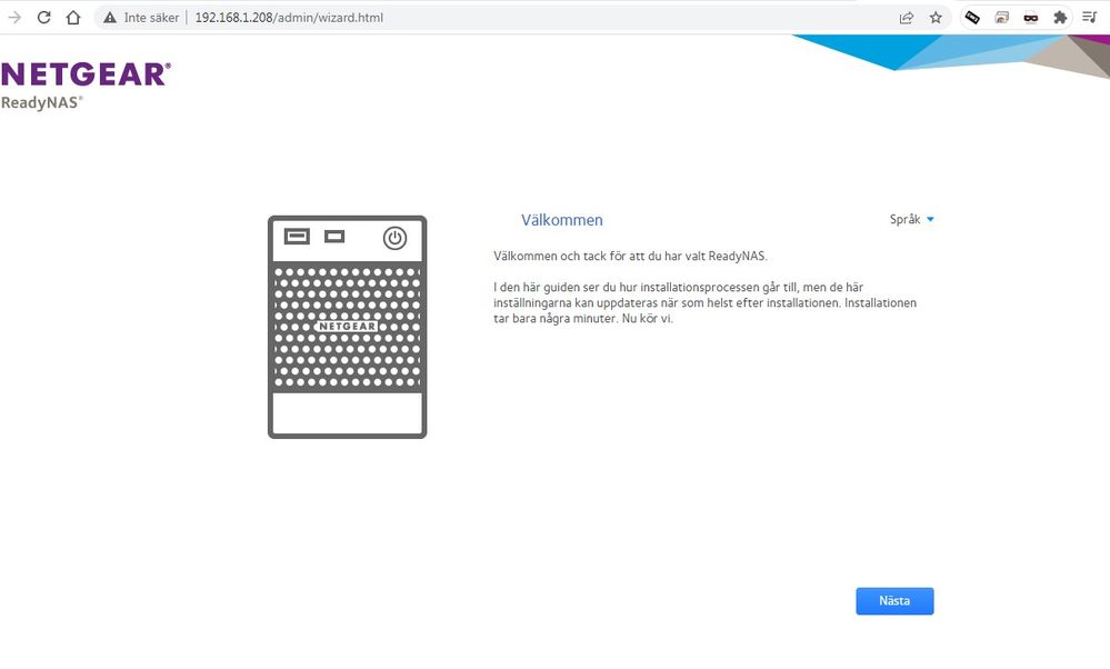

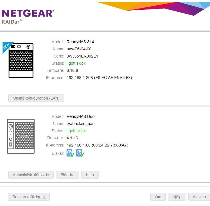

      Actually I can access the NAS if I remove the disks, It also shows its a new disk so I guess that my "USB Recovery Tool" did some effects.

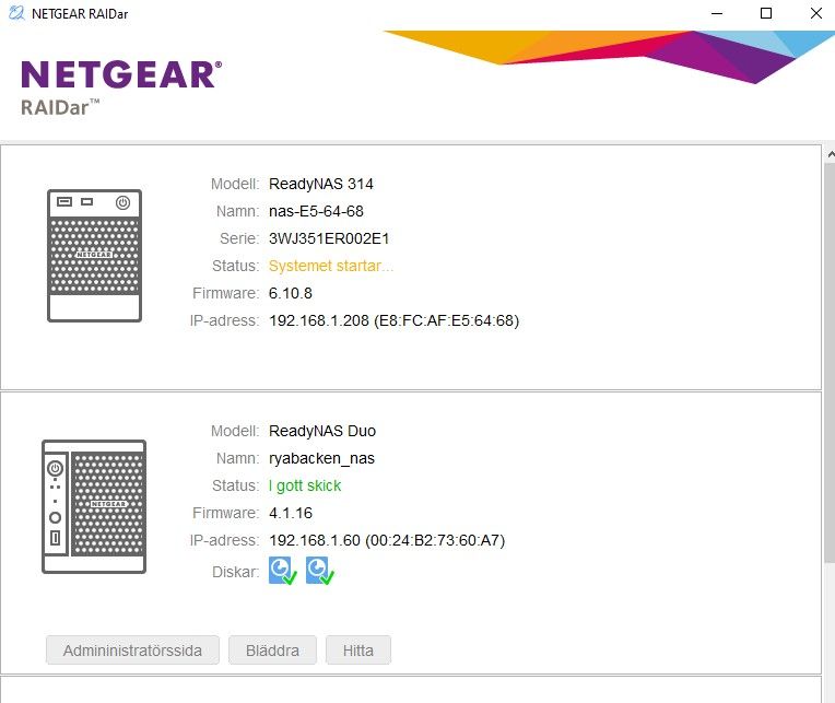

      if i start the NAS with the disks the fan never stops (days) ant the green diode always blinks.
