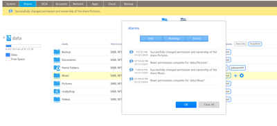

Then I performed the reset on both the Music and Pictures shares. Here are the success messages.
One thing I notice is that the shares are referred to as data\Music and data\Pictures. Also the word 'data' appears top left in the Shares screen. I'm not too sure what that refers to, but it has made me wonder: when I am trying to mount the share, should I be including data in the share path?

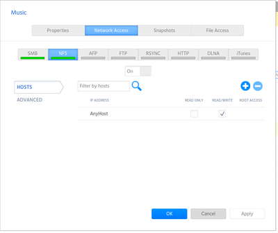

mount.nfs: access denied by server while mounting 192.168.1.41:/data/musicI think I'm fine staying with NFS and having 'Everyone' with access. However, if I go to Network access screen and select NFS, I am unable to add Everyone:
I can't help thinking I'm missing something fundamental here as it seems like providing open access to everyone should be pretty simple.

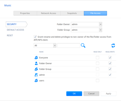

You need to set the file access to Everyone.
- avmadJan 28, 2025Aspirant
Hi again,
I had already done that for both shares actually:
