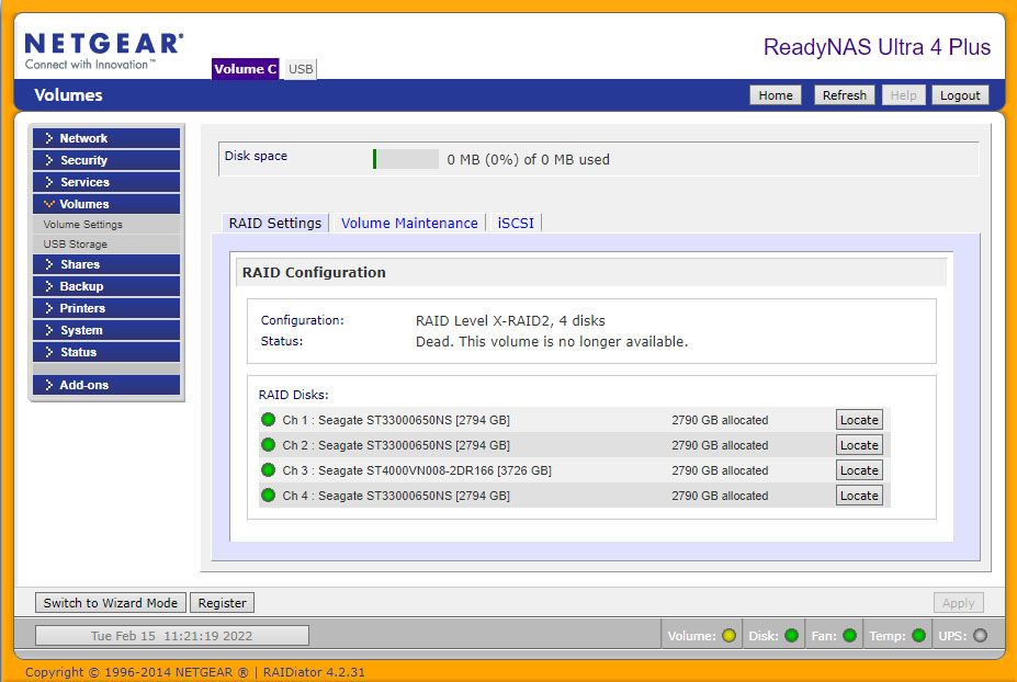

I have a ReadyNAS Ultra 4 Plus that I use primarily for storing music.  It has four Seagate IronWolf drives (3x3TB + 1x4TB) that show green buttons.  The volume is also completely accessible, readable by my Sonos system as well as desktop Windows computer.  However, when checking the Volume Settings-->RAID Configuration, the Status shows "Dead.  This volume is no longer available.".  Disk space also shows "0 MB (0%) of 0 MB used".

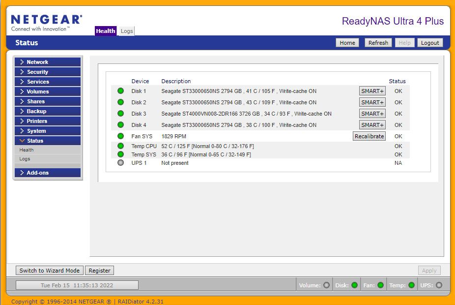

Under Status-->Health, all buttons are green and drives are all "OK".
Is this just a glitch or something I need to be concerned about?  If a glitch, any way to rectify it?
    I don't know what is going on, but I do recommend that you make sure you have an up-to-date backup.

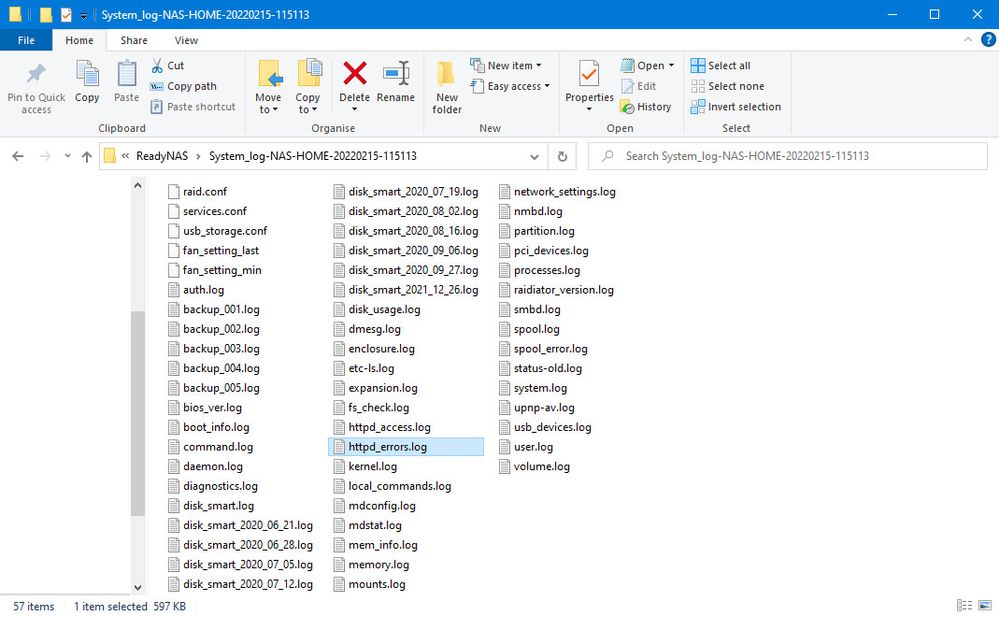

    After that is taken care of, I suggest downloading the log zip file, and looking for RAID (mdadm) and file system, and disk errors.

      Thanks.  I looked through the System Log and cannot see any errors of the type you list.  See anything to be concerned about?
      • StephenB's avatar
        StephenB
        I'd also look in kernel.log.  There should be some error reported saying that the volume is dead - anything leading up to that is likely relevant.
        If you have an up-to-date backup, you could also try rebooting the NAS to see if the problem recurs.
