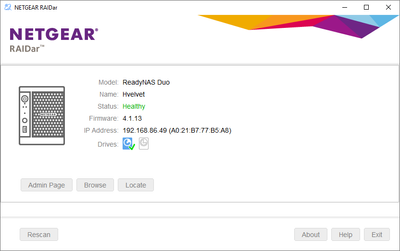

Raidar say's:
ReadyNAS DUO
Firmware: 4.1.13
IP: 192.168.86.49
Status: Healthy
I'm not a network wizz - but I do understand that this IP is local. And that's pretty much the level of my understanding. I've tried to ping that adress - but it times out.

Good, so you have a ReadyNAS Duo v1.
Can you check the IP address of the PC? In particular we need to know if it is also 192.168.86.x

jogyth wrote:
Well - the wireless IPv4 is 192.168.1.41. Was that the one you're looking for?
Yes, and that says something is wrong with your network. The NAS should also have a 192.168.1.x address. Can you double-check the NAS IP address in RAIDar? Also try removing the ethernet cable at the NAS and then reconnecting it.
- jogythOct 08, 2017Tutor
Again - thanks for your effort StephenB!
Network cable unplugged for 2 minutes and then replugged.
Pressed the "rescan" button twice. Still shows the same IP.
