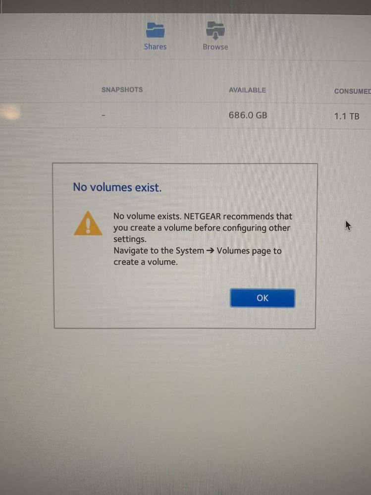

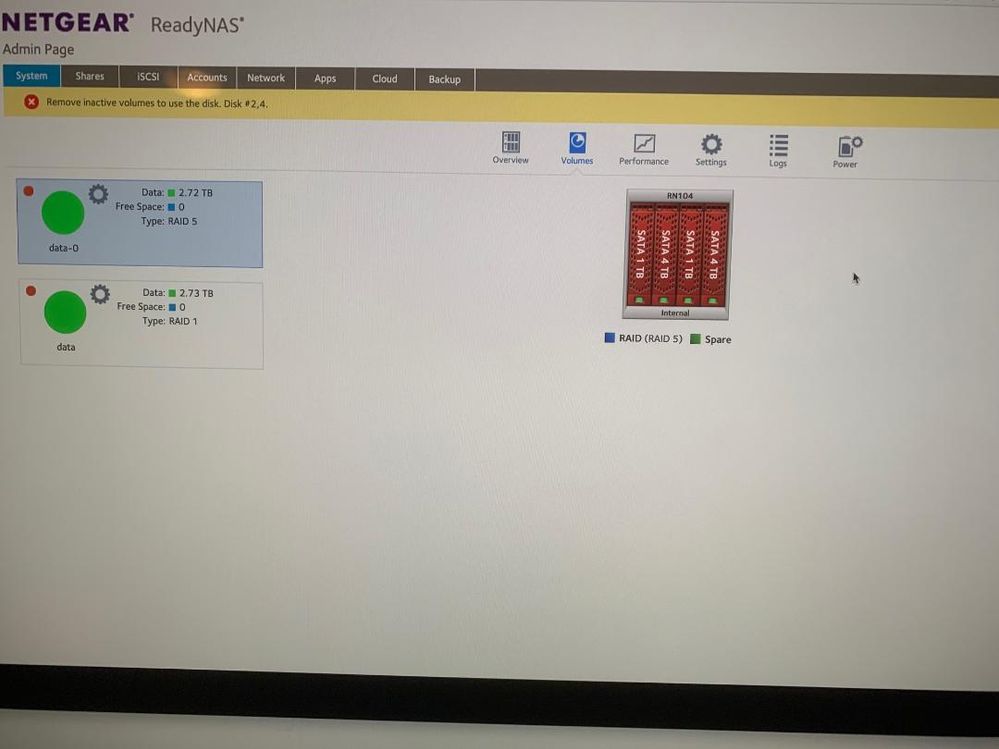

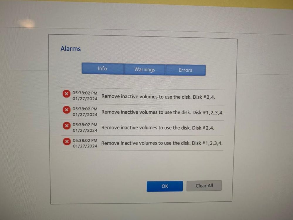

When I got it home this is what I see:
Is there a way to easily just mount them back correctly? Looks like the data is still there. Not sure why it did this, or how to fix it. I have a download of my logs and can PM the link of them to anyone who needs them.

Without asking, the repairman took out each drive from my ReadyNAS 104 to check if the drives were still good. He says he took out one at a time and put them back one at a time into the same slot, and then it took ages for a system restore.
He did the wrong thing. He should have powered the NAS down before removing the drives, and left it down until they were all returned.
If you PM me the link, I can take a look. Likely the volume is just out of sync - if that is the case, I can give you instructions on how fo forcibly assemble the array.
