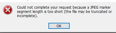

However, now I have just noticed that when I download a file, whether a document or an image, although the file size indicates that it has downloaded the file, the file cannot be opened. It is like all files are the correct size, but somehow corrupt?
Have anyone had this issue? Any recommendations on how to fix, or is it even possible to fix? Below the error I get for a jpg file.

This is the error for a jpg file that appears the correct size
