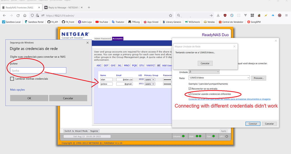

    A remark I think it's worth is that I couldn't connect to my shares without enabling guest logins in Gpedit.msc (which is kinda unsafe but wouldnt't make such a difference in my home network). This is disabled by default on W10 (as in previous versions I was able to connect normally even with SMBv3). I tried to connect with the same user that I created through the frontview panel in the NAS but without success, so it tries to connect with my MS account and fallback to the guest one, so it connects as long as I disable this security check. If any experienced Windows user did make it work, I would appreciate how it was done!
      Have you tried this test?  Open CMD on the PC and enter
      net use * /delete /y
      net use z: \\nas-ip-address\sharename /user:username userpassword
      using the real NAS ip address and sharename of course, and the username and password you created for the account in frontview.
      The first command closes out any open SMB sessions, the second maps the share to drive letter z.
      • potew's avatar
        potew
        Tested here and it seem to have worked, I disabled the guest logins in the group policy manager, and still can connect to the newly added shares. Many thanks for this advice.
