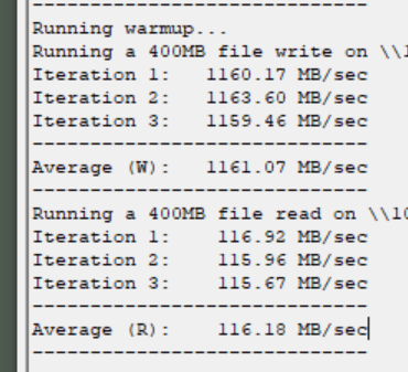

we currently use a Netgear ReadyNAS RR4312X (for 2 years now) connected to a 10 Gb Netgear switch. Everything worked fine until a couple of weeks ago when we observed some overall system lag (about 2-3s sometimes) as well as a speed cap for reads only to 100Mb. We have 2 volumes in operation, one 5 Disk Raid 5 with Seagate 12TB exos disks (tiered with 2 SSDs) and another 5 Disk Raid 5 with Samsung 512 GB SSDs. Here's a screenshot of the write speed vs the read speeds:

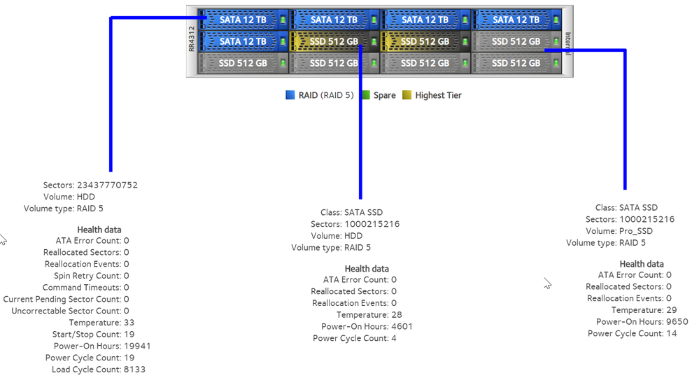

and one with the disk setup plus some disk data
Before this strange speed cap on reads we had the same speed for reads and write (10gbps cap) on anyone of the 2 volumes and 0 lag in the system. All the disks appear to be in very good condition and are relatively new.

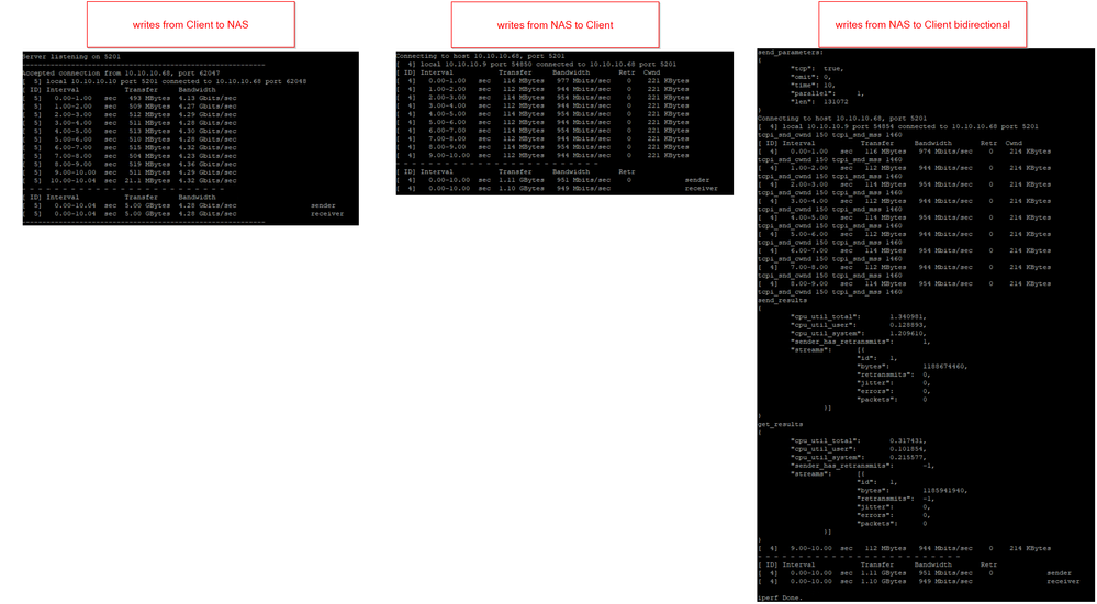

      Here are the results with iperf:

        iperf also shows 1 gigabit in the NAS->Client direction, so this appears to be network related.
