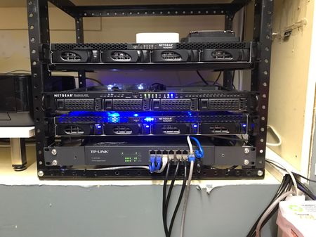

Thanks for sharing your pictures BTW, and details on your chassis mods.
