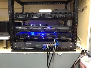

Thanks for sharing your pictures BTW, and details on your chassis mods.

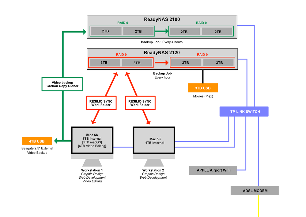

4. I think I am going to use Resilio for a sync between the server and our workstations. We have one WORK folder where we do graphic design and that folder needs to be synced with all designers (only 2 of us for now).
I have made a diagram of the current network. The ADSL Modem is in my home (40m Cat6 cable), while my studio is in my garage. Thats why I created another wifi in the studio via a Apple Airport.
QUESTION : The main thing is should I use the RN2120 or the RN2100 as the MAIN NAS. This will share our pictures, vectors, music, Fonts, Downloads, Cloudk Syncs (dropbox, OneDrive), Software Updates, Tutorials, Drivers, Books etc etc). The RN2100 has 2mb RAM but I can upgrade to 4mb soon. What is your opinion of the 2120 vs 2100 ?

Note that I don't own either one. Your 2100 must be a 2100v2 (otherwise it couldn't run OS-6). so it uses the same Atom D510 CPU as the Pro-4. The RN2120 uses an ARM processor - there is a RN2120v2 also, which has a faster CPU.
My impression is that the RN2100v2 is faster than the RN2120v1, and about the same as the RN2120v2. If performance is about the same, I'd use the RN2120 as the main NAS, because it is newer.
