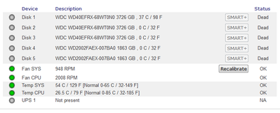

Hi

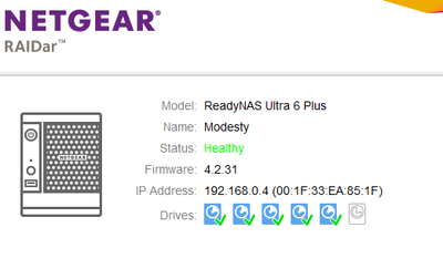

yesterday all was good, today all 5 disks dead...
Raidar report Helaty
I dont think is is the disks that makes this issue, can it be the NAS box HW?
What are my options?

    You are saying that everything works - including access to the web ui and the shares?
    If that's correct, then the first thing to do is create (or update) your backup.
    Then power down the NAS, and remove the disks (labeling them by slot).  Then test them in a windows PC using LifeGuard.  You can connect them with either SATA or a USB Adapter/Dock.
    If you have a spare disk (not in the array), you can also try doing a factory install in the NAS while the disk tests are running.  If that is successful, then try powering up the NAS with that disk in each of the 6 slots.  That will test the SATA interfaces in the chassis.

  • While I never had them all do it at once, I had a Pro6 with a mix of 7200 and 5900 RPM drives running OD4.2.something that would occasionally have one or more go "dead" even though all were actually fine.  I would remove each, renisert, let it re-sync, and all was fine for a while; then it would happen again.  I turned off drive spin-down, and it fixed the problem.  I later upgraded to OS6.0, and had no problems, even with spin-down enabled.
    I came to the conclusion that differing spin-up times were confusing the NAS; but I dont have hard evidence, just circumstantial.

      Disk 1-3 is WDC WD40EFRX-68WT0N0 3726 GB - 5400 rpm
      Disk 4-5 is WDC WD2002FAEX-007BA0 1863 GB - 7200 rpm
      4-5 is older than 1-3

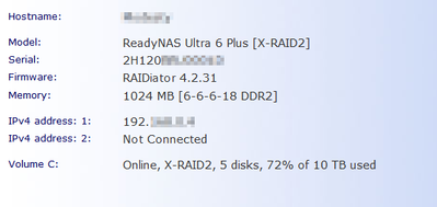

        Yes, I meant OS4.2, not OD.  That's the firmware family for legacy Intel NASes.  I switched to OS6 well before the version you are on.  I noticed the drive speed difference from the screen capture you provided, which is why I offered my experience of something perhaps similar.
        Yes, you should remove and replace the drives one at a time with power on.  Give the NAS time to report the removal before re-inserting.  Each will need to re-sync, so total time is going to be a lot.
