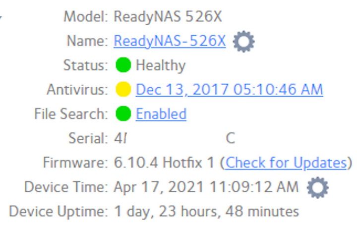

- Jetlag1Apr 15, 2021Guide
I sent you a PM, no reply yet.
After several reboots and switching AV on and off still not able to get AV Defs
running 6.10.4 Hotfix 1
ReadyNAS 526X

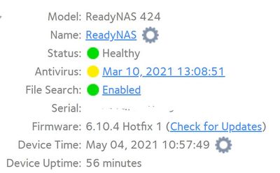

- swehjoMay 04, 2021Guide
Have had this issue from time to time but since March it's persistent... Rebooting every night. Tried to upload a screen shot but it didn't work, so:
- Model ReadyNAS 424
- Antivirus: Mar 10, 2021 13:08:51
- Firmware: 6.10.4 Hotfix 1
Error message is "System: Antivirus scanner definition file update failed due to download failure. Check your Internet connection."

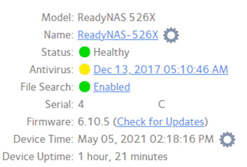

- Jetlag1May 05, 2021Guide
I just downloaded and installed FW 6.10.5 and rebooted.
15 minutes later I get this email: "Antivirus scanner definition file update failed due to download failure. Check your Internet connection."
JFC! Seriously? It was suposed to fix this issue.

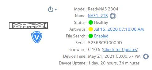

- leftcoastmarkMay 21, 2021Aspirant
No change for me either, running release version of 6.10.5. ReadyNas 2304.
The release notes say it fixes the Antivirus Update bug on ARM machines, but I believe the 2304 is an x86 machine, no?I've tried rebooting (including a cold boot), and disabling Antivirus then re-enabling. It's been a few days now and I get a failure in the logs each day. - the usual "check your internet" message that everyone here seems to get.
