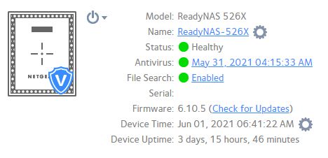

- Jetlag1Jun 01, 2021Guide
I would publically thank Justin dingjs1421 for remotely fixing this issue on my 526X.
Got a PM from him as soon as I logged on this morning, virus definitions are now current.
Thanks Justin, nice work!

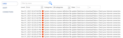

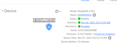

- diegobaccinoNov 01, 2021Aspirant
I'm also encoutering this problem. Running version 6.10.5 Hotfix 1. The AV has not been able to update since October. Can you please help me in solving this issue? This is happening across all devices running 6.10.5.
Tried removing files in /var/lib/clamav folder but freshclam is unable to update. Also tried changing the DBMirror to a specific working mirror but still receiving the same message. As you can see from below, access to DNS and Gateway is not a problem for this box. Any ideas? Thanks for your help.
freshclam

Address 4: 2606:4700::6810:da54 - scrjsNov 01, 2021Apprentice
