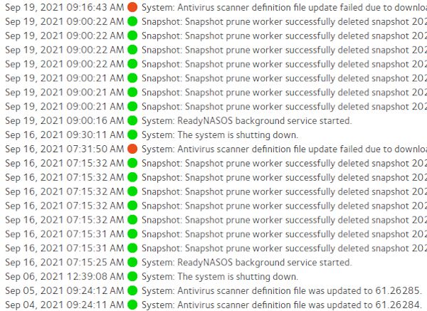

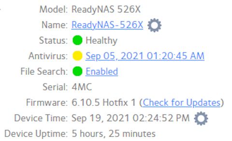

Damn, just a few months after it was repaired my antivirus definitions have begun failing again. Last successfull update was 9-5-2021.
