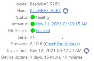

- Jetlag1Nov 12, 2021Guide
6.10.6 fixed this issue on my 526X, functioning perfectly again.
